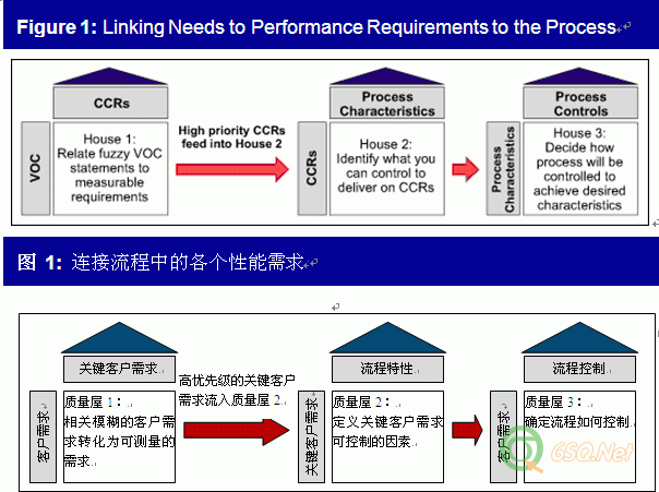

The rest of the QFD analysis is based around a series of specialized matrices (each a house of quality) that help the team link the needs first to specific performance requirements and then to operational factors in the process that will guarantee those requirements are met (Figure 1).
接下来QFD分析一系列的矩阵图(每一个都是一个质量屋),这些矩阵图用于连接流程中的各个性能需求(图1)。
Figure 1: Linking Needs to Performance Requirements to the Process
图 1: 连接流程中的各个性能需求

QFD需要进一步的转化。而质量屋3的建立,是用来解决重要流程的监测和控制问题的。项目成员识别相关数据并建立机制进行收集和绘图。机制是实时的,且不超过24小时。异常被记录下来,且当足够多的数据收集后系统能自动更新。换句话说,这个测量/控制系统具有“学习”功能。
The beauty of these interlinking houses of quality is that the project team can explain exactly why each process element and control mechanism is in place - because the team can link it directly back to customer statements or regulatory requirements.
这些互联的质量屋的优点在于,它们解释了流程和控制机制。因为通过这些流程,项目成员们能回溯到之前的客户陈述和监管要求。
